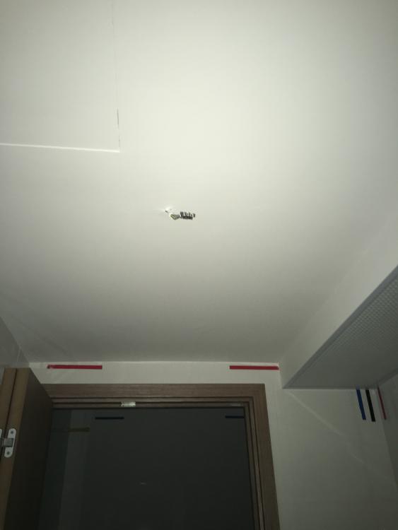

Hi @mmoh,
As you can see the different from your toilet ceiling. The height become quite intimidating but it is quite solid. But I am just afraid of mickey mouse and xiao qiang hiding in there or the pipes leaking but cannot see.

5 hours ago, CaseBlue said:
Hi @mmoh,
Interesting new design nowadays.
I agree over time, it may rot or have pests living inside.
some people just do without thinking of long term ....:angry:
Well, i guess its HDB way of covering up the bathroom sanitary pipes I guess.
Another good point I realized when living highest floor is that there are no such pipes in my bathroom.
On 5/25/2018 at 12:09 AM, CaseBlue said:
Hi @mmoh,
if it is fully covered then still ok lah, except of the low height. if high floor then unlikely got mickey mouse.

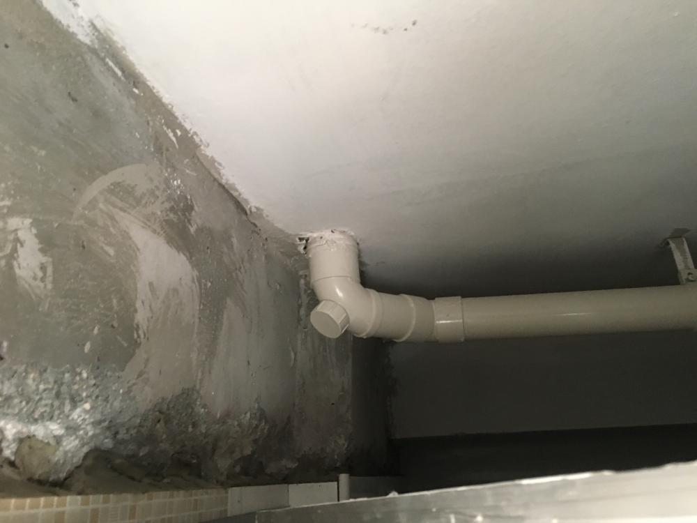

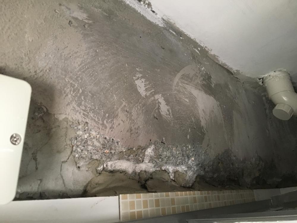

I managed to look inside the false ceiling, as i suspected, the tiles are incomplete and cement exposing raw ... sigh ... maybe use false ceiling to conceal rush work ...

7 hours ago, CaseBlue said:
I managed to look inside the false ceiling, as i suspected, the tiles are incomplete and cement exposing raw ... sigh ... should be false ceiling to conceal rush work ...
Wow i'm sorry to see that. The raw cement really looks like a rush job. I'd expect them to at least screed properly.
The way I see it, you have 2 choices to rectify this:
1) Get BSC to do a proper patch up.
2) Get BSC to remove the false ceiling, and pay contractor to do a nicer looking ceiling.

On 6/8/2018 at 8:58 AM, CaseBlue said:
Heartache seriously... oh why must get BSC to remove? Will they do that for us?
BTW, any comments of your flat after staying for months liao?
Depends on the BSC. Just let them know got defect and need to remove.
Do note, the wait might be very long as the BSC need to tend to every residents in your project.
If not, you will need to get your contractor to remove.
if u hv false ceiling, then your neighbours shd have false ceiling too. guess the contractor think that since it is hidden, then dun need to touch up nice nice.
if u wanna remove the false ceiling, then maybe they can help you to scrap off those extra cement. but if u expect them to remove the false ceiling, scrap off those extra cement and then still put back the false ceiling, i doubt they will do it. but no harm to ask lah.
