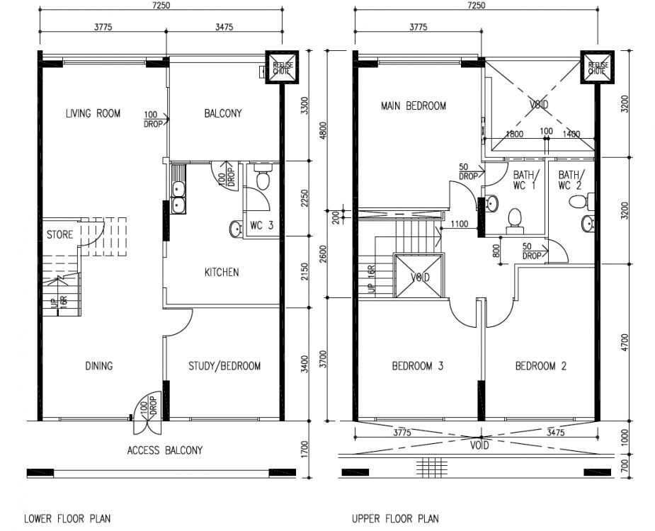

Edited by jeremylm
Adding the floor plan

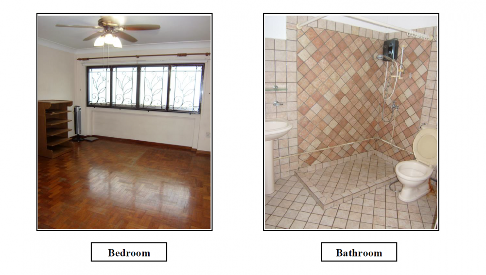

Some pictures of the current condition.
Major reno will be done, we will only keep and vanish the parquet in the bed rooms.
Stay tune for my wife to update.

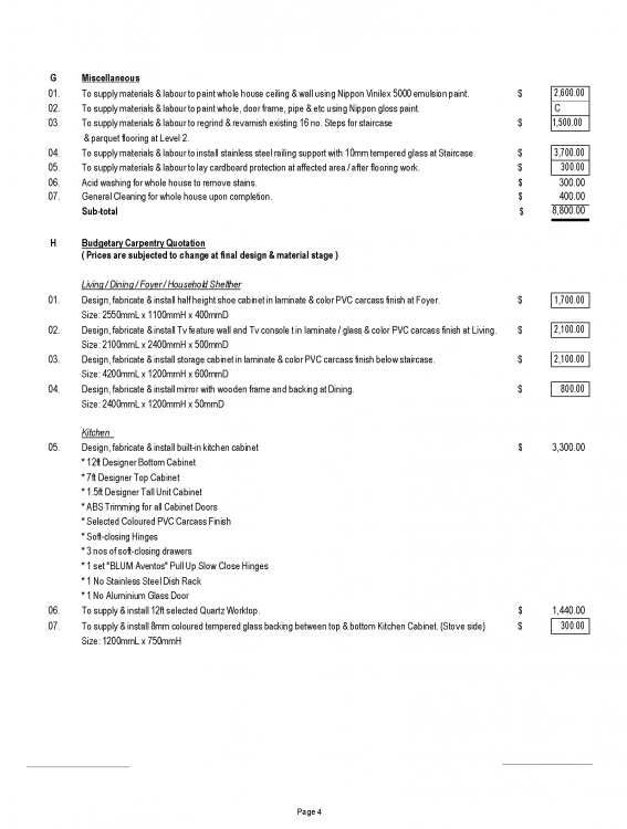

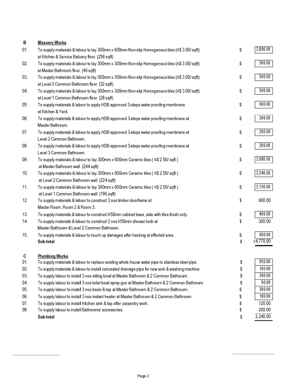

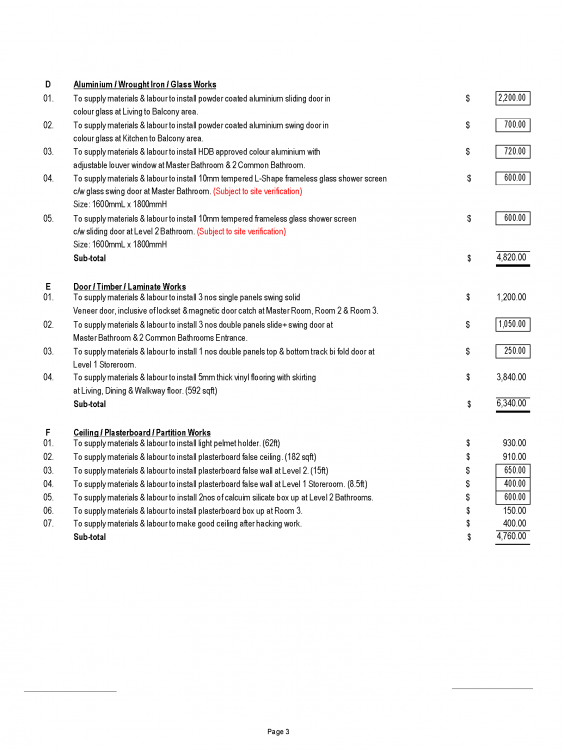

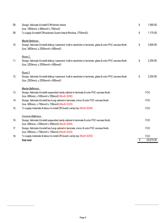

Just got my 1st quote.
Pls feel free to give me comments and advise if the pricing given are accordingly to market rate.

I'm also living in an EM! Good space! I think quote is in the range for EMs. I'm planning my 4room BTO now so can't help much.
