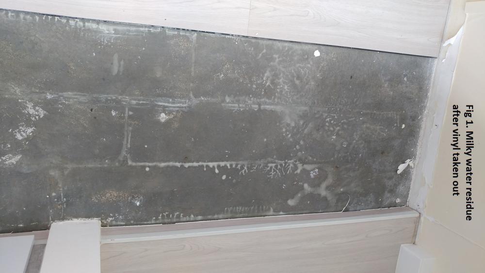

I've bought a high floor 20yo HDB resale unit and the renovations have completed more than 6 mths ago. Trouble start brewing last Nov (2017) when I notice water bubbles coming out of my vinyl flooring seams in my master bedroom. Mould mites can also be seen crawling near the area.
Got a shock of my life when the vinyl is removed as there is a pool of milky looking water underneath the vinyl (fig. 1)

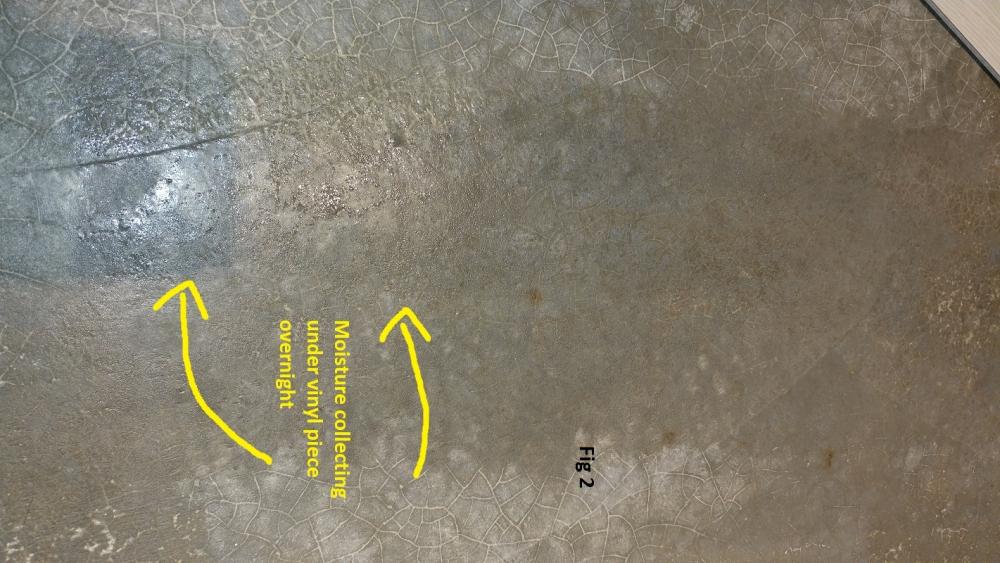

The floor screed appears wet (darker colour) and moisture can be seen collecting on the underside of a vinyl piece placed overnight (fig. 2 see the water sheen).

Here's an update of the condition after I purposely lay back the vinyl tiles for 2 days and then removing them.
I have a qns though.
Is there anyway to confirm it is indeed too much moisture in the floor screed without a moisture meter vs other factors?
I would expect my entire bedroom floor to be affected if it is due to screed issue but apparently it is only confine to just 1/3 of my bedroom which is near to window.
