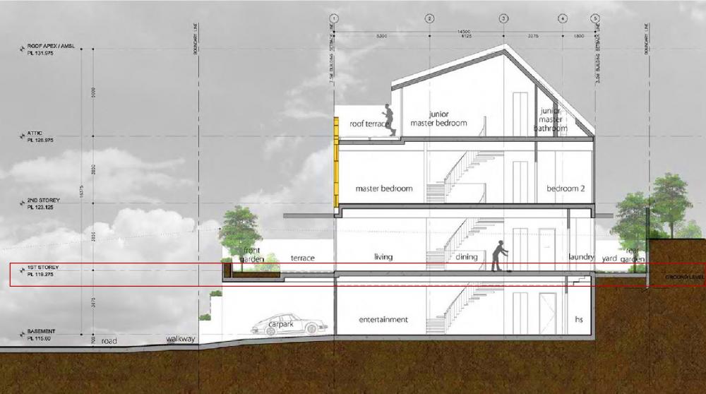

as the front of the house at road level is much lower than the rear of the house they can declare the car park as a basement since the houses are built on a "sloping" ground and the basement is fully enclosed save for the entrance to the car park. so the "car porch roof" you see is technically the first storey floor stab which has some set back from the boundary.

if you want a basement for your house, it must be fully enclosed or have a max of 1 meter protrusion from the ground. unless your house is in a low lying area where the existing ground level is below the MPL then you can have an exposed basement since anything below that MPL can be declared as a basement. if your house is on a sloping terrain, then it's up to your architect to design the basement and whether URA accepts the design based on the current planning guidelines or not.
edit: developer has declared a ground level at PL119.275. so anything that is below this level is considered a basement. Also the development was approved in 2014 which was before the envelop control guidelines came into place. so many things which can be done before the envelop control guidelines is not allowed to be done now.
