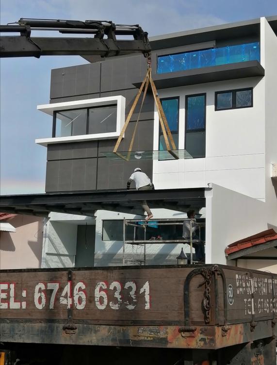

I think is not a straight forward thingy just by replacing with cantilevered roof, I remembered that when I decided to change to laminated glass instead of polycarbonate sheets, the Structural engineer got to do resubmission as glass is much heavier and stronger concrete beam and steel bar needed

Its more of a personal preference and also I saw quite a bit of polycarbonate sheets turn yellow over time and kind of aesthetically unpleasant.

Its quite a huge job from design phase to erecting reinforced concrete beam, I beam and laying of laminated glass.
