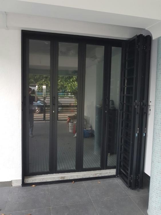

A pity that grilles significantly affect the overall aesthetic. The best option I've found for folding glass doors is folding grilles. Takes up double the space for the tracks and looks bulky when it's folded to the side.
Example here:

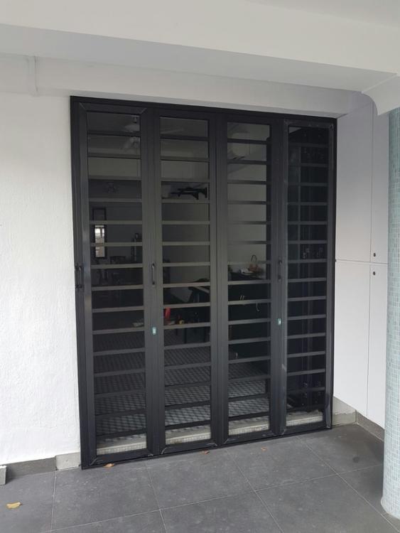

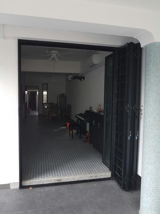

there's other grilles design to choose from. this particular one has an additional frame in between each panel for the pull handle hence adding to the bulk. also the bars in between is quite thick which isn't pleasing to the eye. of cos one man's meat is another man's poison.
as the grilles are customised to each doorway, you can choose the materials and design as well as the swing directions. there's no fixed rule that all the grilles have to be bifold and open to one side. you can also split the grille into 2 such that 2 panels open to each side.
if i was the house owner of the photo example, i would have asked for the grilles to be swung open the other side (left instead of right) and the entire panels can be swung 180 degrees such that all the panels are flat against the wall on the left. with current design, the grilles block the shoe cabinet when open which is bad design as the thought process wasn't done properly on the usage.
just to share an example of my grilles, I had requested for a split 4 panels design so the lock is in the middle and each side has 2 panels. but I has requested for different swing directions for both sides. on the left side, it is the "normal" swing where the end position is at 90 degrees. but for the right side, i had opposite swing such that after opening, i can flush the 2 grilles flat to the wall instead of a 90 degrees protrusion. this will effectively remove the obstruction of having the grilles stuck at 90 degrees. but the downside of this design is that both panels need to be unlatched in order to swing out the grilles as opposed to just needing to unlock/unlatch one panel. also, by choosing thinner rods (with a steel rod insert), the grilles looks less intimidating and reduces the bulk.
Also I have sliding doors instead of bifold doors so my opening is always limited to 50 percent as i only have 2 tracks (plus 1 frame for grilles). if you want to do bifold doors, my advise is to do one with bottom track and rollers as well. the bifold door is heavy and if just supported by top hung tracks, it may sag over time or rollers fail and eventually give you problems.

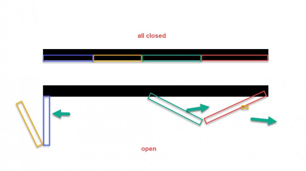

see how the panels are hinged to each other and the frame. basically the red panel can fold 180 degrees to the wall on the right and the green panel then end up being folded on top of the red panel.
Thanks for the detailed diagram!
