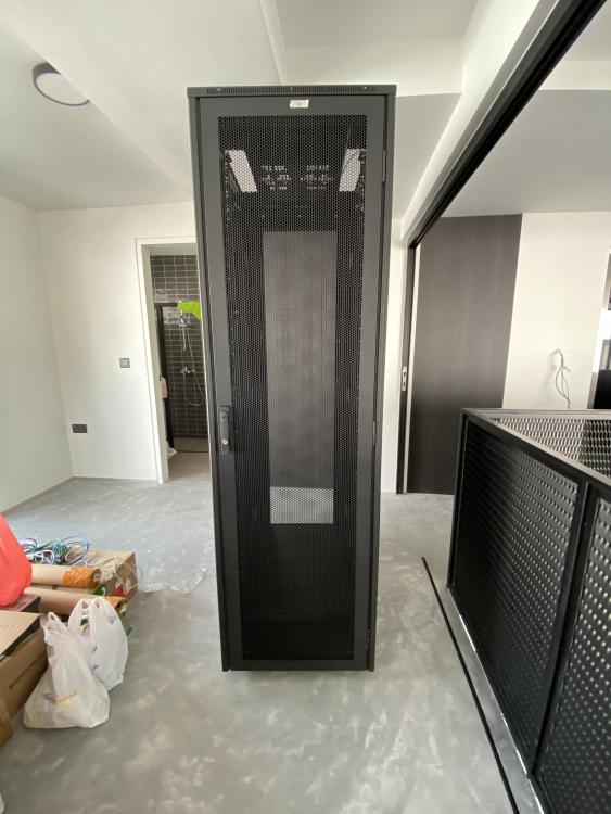

Also, roughly how much space does your server rack occupy. Would like to see if I can fit something like this into one of my cabinets.
My server rack is 600mm wide x 1000mm deep x 2100mm tall. This is a full sized server rack usually used in data centers.
600mm wide is minimum as the normal rack mounted equipments will be around 500mm wide. There are also wider, shorter and less deep ones as well. Some small ones can be mounted on the wall near the ceiling as well
Is there anything special about a server rack? compared to any shelf? Eg. cooling fan.
just wondering if I can simply put the switch etc into an existing cabinet without getting a rack.
yes there are cooling fans that can be installed on top to extract the hot air.
a server rack has standard sized mounting brackets for my networking equipment to mount to. also all my network cables are terminated onto a patch panel and then patch cords are used to connect the network switch to the network points on the patch panel. it just makes things neater and easier to maintain for me. also i have a rack mounted backup battery for my networking equipment, CCTV and video doorbell/intercom system as well.
of cos you can do put your equipment anywhere you wish to. just that having 20 to 30 cables to manage is not going to be easy to organise and maintain. ultimately, it's up to individual preference.

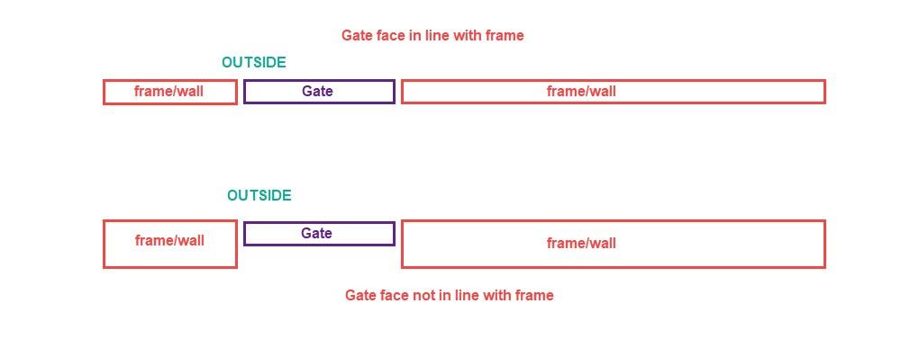

Does anyone have local contacts to buy direct for Viro or Cisa electric locks for side gate? A few I contacted wanted sell at $800-$1000 that includes installation. I believe the lock costs around $200+ and power supply ($20-$30) based on what I see on overseas online shops. My electrician is already laying the wiring to the gate so I find the $800 labour charge just to install and wire to my intercom quite exorbitant.

before deciding on which rim lock to buy, look at the design of your side gate and the frame/wall first. if your side gate and frame/wall has the faces in line with each other(on the inside), then the Viro or Cisa lock which AWS recommended would work. but if you have gate which has its face not in line with the frame/wall, then the Cisa lock which AWS recommended can't work since you can't mount the strike at the side of the gate frame or wall. Even for the Viro rim lock, you will have to find creative ways to mount the strike plate as well.
for my house, the gate and frame/wall is not in line so I had to do some modifications for the rim lock to work properly.
