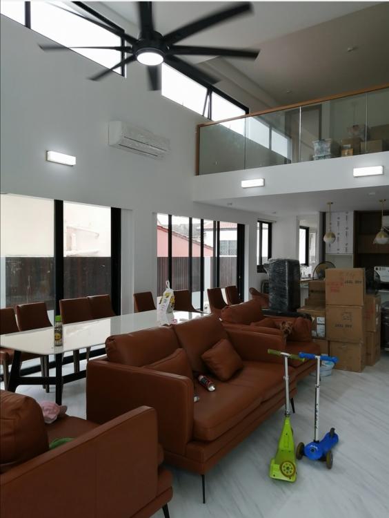

I had one, but my living room height is 5.6m. My mezzanine and below it is about 2.6m.

I have a mezzanine floor like George as well. This creates a double volume ceiling for my living room which helps ventilate the living room as well as make it brighter and spacious.

just to share with you my floor to floor storeys height.
ground floor to mezzanine - 2.8m
mezzanine to 2nd storey - 2.7m
2nd storey to attic - 3m
attic to root - 3.5m
my mezzanine storey areas/rooms do not have any false ceiling as the height is just over 2.4m from floor to ceiling slab. some parts are slightly lower due to the beams running across the rooms as well. but because the rooms aren't that big and it's next to the double volume living room, i don't get the claustrophobic feeling when inside the rooms. and due to how my architect designed the rooms and how the PE designed the structure, we are also able to put in ceiling fans for the rooms as well.
