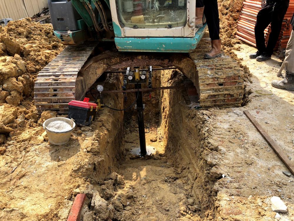

Example of plate bearing test being conducted from one of my current projects. The weight used is the weight of the excavator itself. $2k for such a test is reasonable and is necessary. It is a BCA requirement to do so.

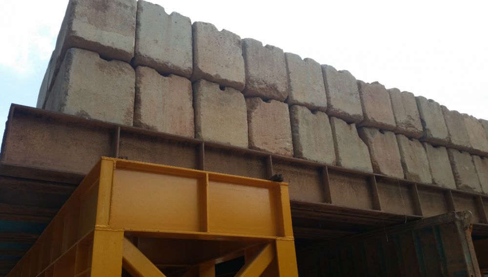

PDA - (Pile Driving Analyzer) test is actually more when piles are the foundation type. And if necessary, they will conduct the ULT (Ulitmate Load Test) using the gigantic rocks like in the photo below:
This is photo of plate bearing test done for my house. test is done on excavated ground at 1.5m deep as that is the depth of the bottom of my footings as specified by my PE.
