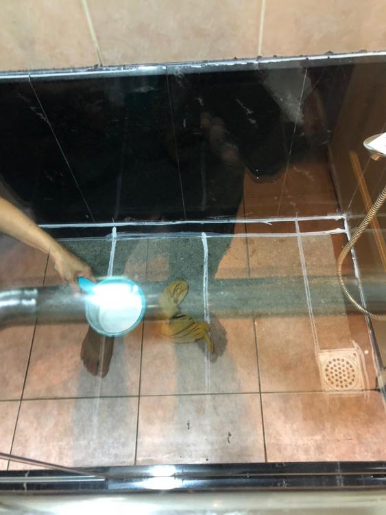

Just an update here for anyone who keen to know more.
The tiler came and apply QUICSEAL 107 on the bathroom.
After a month. It seems the water seepage issue is now resolved.

I have similar situation as you and have shared my pic with you. My contractor came and rectified the water seepage problem for me today......it has to do with poor water proofing. The worker re waterproof the flooring and walls by pumping in a certain chemical into the surface. As of now, it seems alright. Hope everything will be good after this.
I also suspected as much
