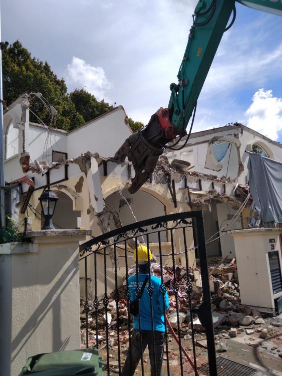

Demolition finally done. After a lot of official paperwork with LTA, URA, BCA, PUB.
