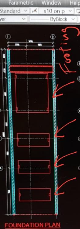

Back to this case, he explained the $240k quoted for structural works for the 3 levels + attic inter-t with total buildup of 4000sqft did not include the footings (as shown in the drawing attached) as he assumed piling would likely be needed.
He estimated that those footing as indicated by the arrows would required 3x more cement and rebars as compared to what he has quoted for the structural works. He said that the actual cost increased would likely be more than $60k in today's Covid context.
Sounds reasonable?
Sounds reasonable?
Architects would usually find 3 to 5 contractors to bid for the job. Of cos there will be contractors whom they had worked with before on previous jobs who are invited for the tender. Look at it this way. If the contractor isn’t up to par previously, would the architect invite him to bid for another job? The architect also won’t want problems with a problematic contractor as well right?
honestly speaking, if the contractor has not meant to include foundation work in the original quotation, then all the items related to foundation should not be in the quotation in the first place. It’s like you go to a showroom to buy a car, then you want to upgrade to bigger rims and tyres and the car dealer tells you that the original quotation for the car didn’t cater for rims and tyres.
if the contractor says the new footings are 3 times larger then original then I would ask for the original drawings to see what was the original estimated footings size. It is easy to calculate the additional materials required when you have the original and new structural plans to compare with.
as mentioned, you are at the mercy of your contractor now. Whether the additional cost is reasonable or not doesn’t make a difference since you have signed the contract and such and don’t really have any other options to move forward besides accepting this new extra cost.
