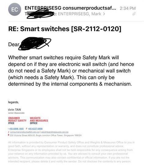

If you really want to have these smart switches, do tell your electrician in advanced so that neutral cables can be pulled to every switch location. Even though there are smart switches which doesn't need the neutral cable, I've seen quite a number of photos of them melting after some time. Also some smart switches require the neutral cable in order to work.
The other question is the availability of smart switches with safety mark. Without safety mark, you will definitely not pass the SP inspection prior to TOP approval for your house. So the only way to circumvent this is to change to smart switches after the inspection. But how to hide the neutral cable is another thing you need to consider since random switches/sockets may be asked to be removed during the inspection.
