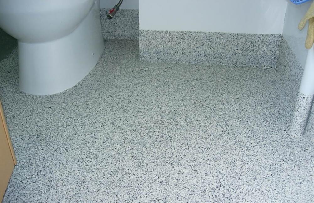

you can try spray coating as belowDSCN5378.JPG ting coating on tiles ,see https://www.tutto.com.sg or call mr loh at 91386272 below is the toilet he did for my house
does this fade anot over time?
