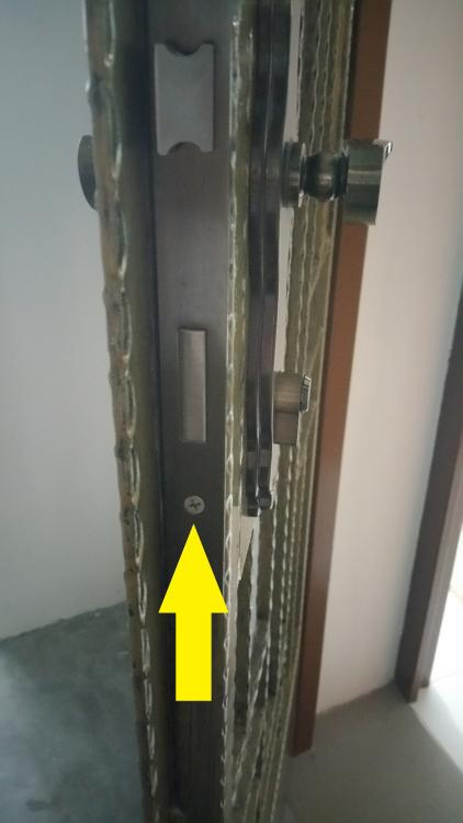

Hi andotang,
Can give more info on how to change the metal gate cylinder? If it is not too complicated I would like to change it myself.
You have provided very detail procedure in you previous post :thumbs up:
Thanks thanks
Sorry for the late reply as I took some time to take a new picture as I feel picture speaks a thousand words.
Metal gate cylinder is slightly more tricky then main door as the locking piston is always protruding out.
You need a philips head screw driver and your metal gate key.
First you unscrew just 1 screw as pointed by the yellow arrow in the pic.
Now this pic show the cylinder for metal gate and main door, you see the locking piston is protruding out by
default whereas main door is seamlessly blend in. So you need to use your metal gate key to turn the locking
piston and wiggle the cylinder out, just apply little force to pull the cylinder out while turning your gate key will
do.
You can take out this cylinder then lock your door with your normal padlock then use this sample to go buy
your cylinder from Homefix or duro headoffice.
Edited by andotang
replace all missing pic, somehow the blog mess up all my posted pic
Hi Andotang,
You are super helpful. Really appreciate your time to explain this. I will try out after I collect my keys in Mar.
Thanks a lot :thumbs up:

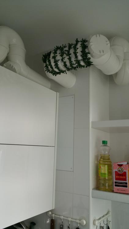

Bought some fake green vines to decor my kitchen to add in some green.

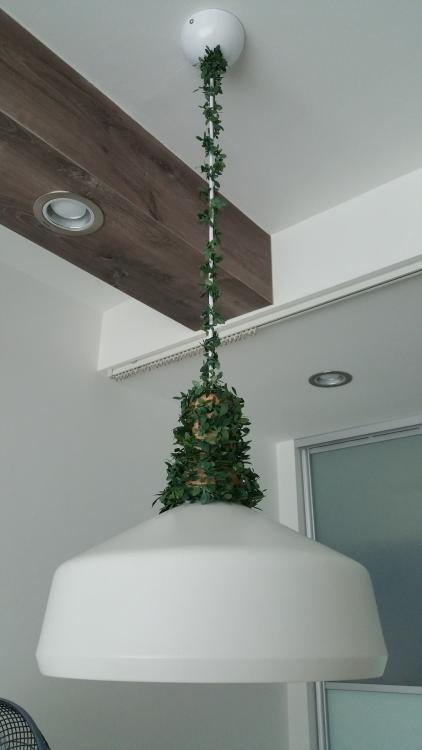

Added some green to my pendant light for dining table. Can also see my curtain track for room partition in false ceiling if necessary then just hang up the curtain for privacy.

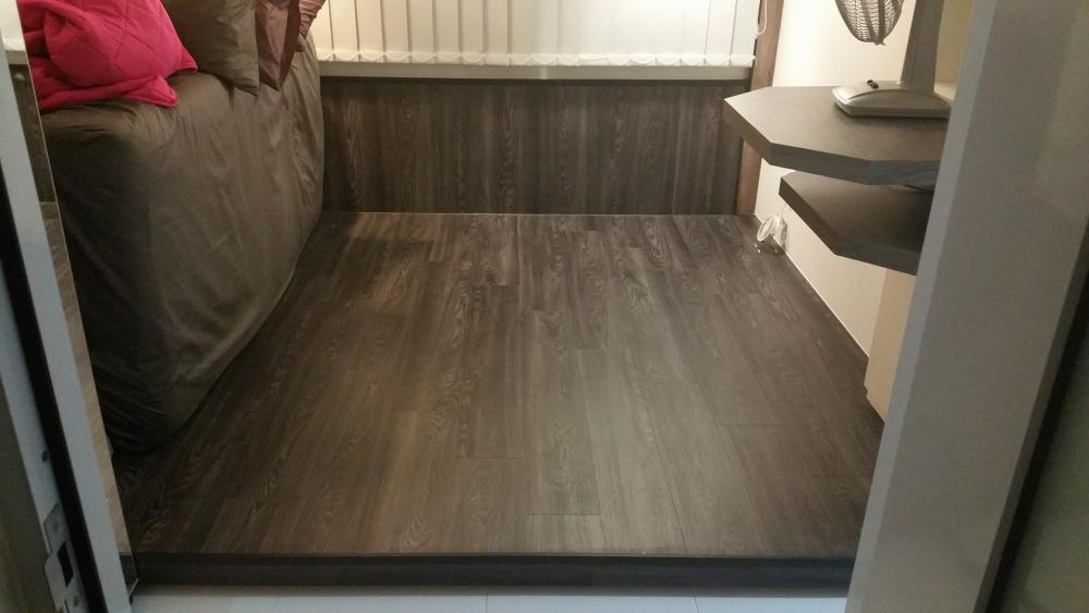

I finally managed to put the mattress aside to see how much space I can free up in the bedroom. This is the normal everyday mode.
This is after I push all my mattress to one side of the wall freeing up the room space. For a small house like mine which only got 1 bedroom, every inch count so this design allow me to free up space for event like makan or mahjong session in the bedroom. Or even yoga session.
I had my bedhead slanted so leaning on it while sitting on the platform is pretty comfortable.
My initial idea was to put the whole bed on one side so I could put a small working table the otherside of the wall for tv or a computer. But then after mattress is in I realized I need walking space to tidy my bedsheet, thus scraping the idea to have any other furniture in my bedroom except a kings bed which is 2x90 single mattress. The amazing experience so far is I really cannot feel anything when my wife woke up cos no movement to my mattress at all as they are 2 individual piece. She can toss and turn on her bed and I don't feel disturbed.

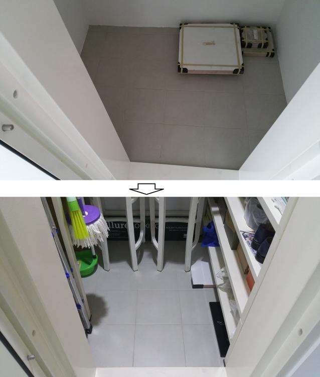

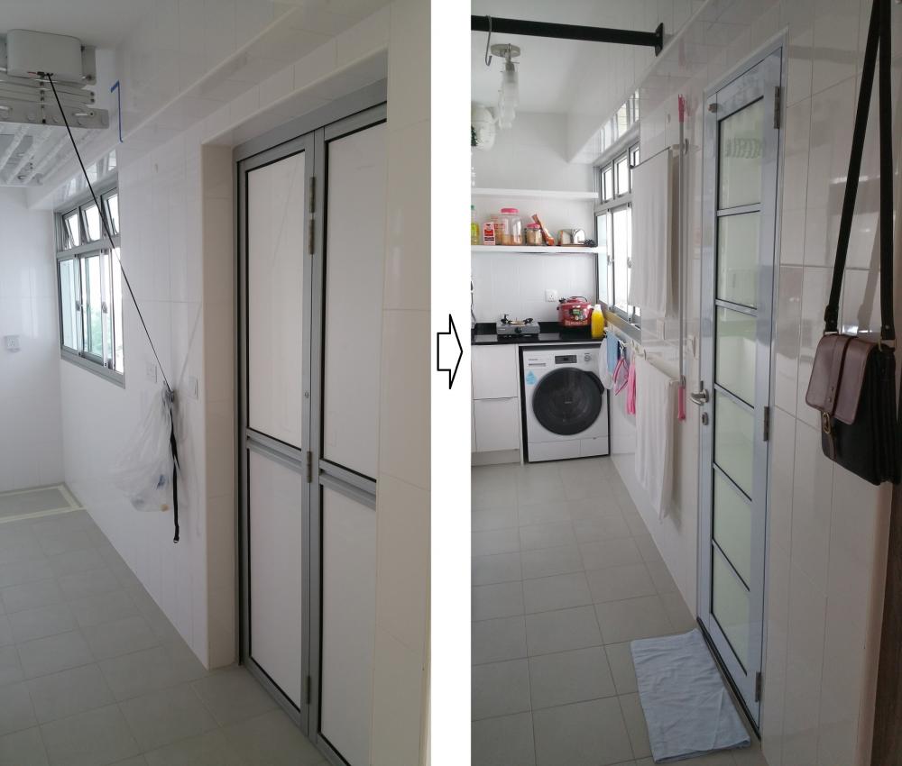

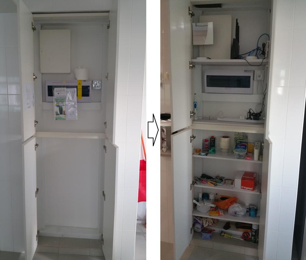

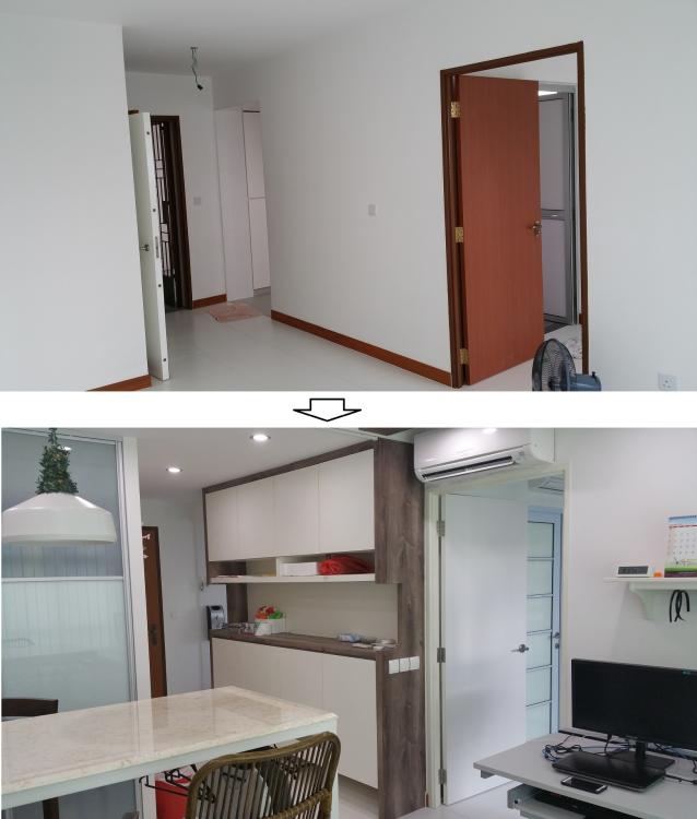

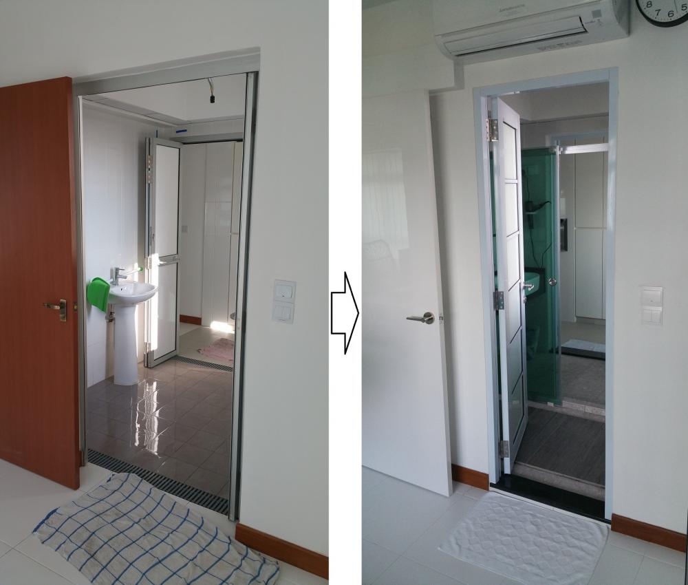

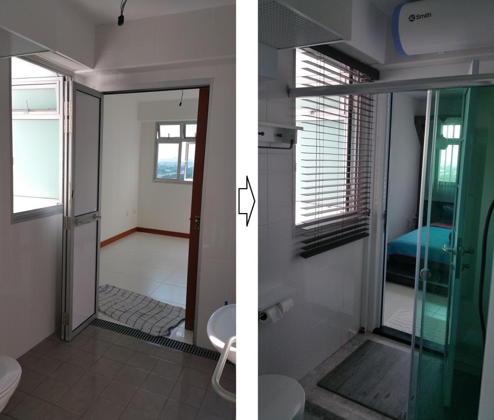

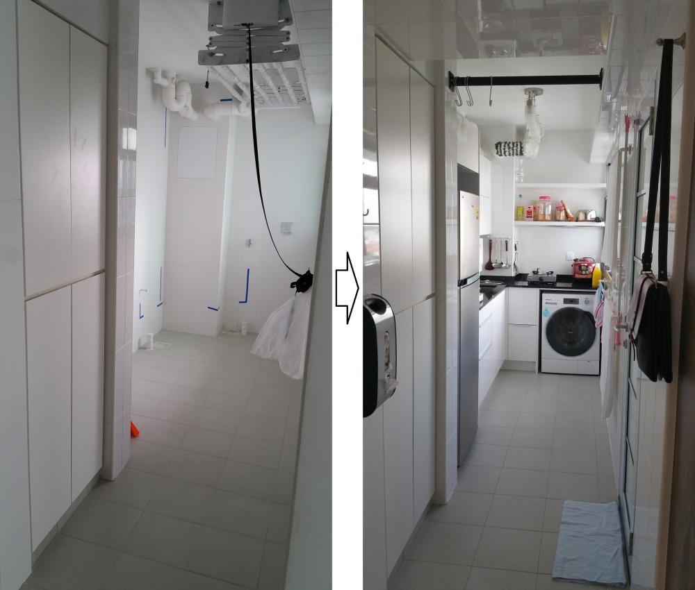

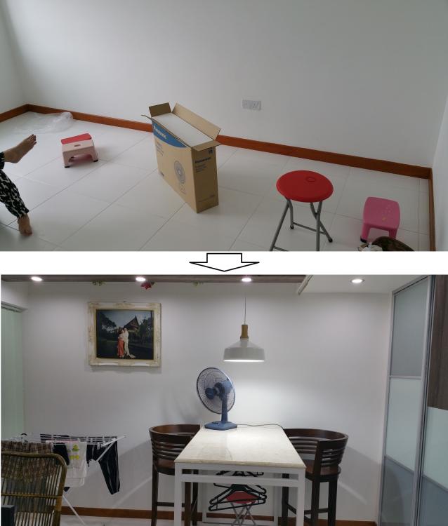

Before and After - Part 1
Done up some before and after pic to add to my blog. Working on a video and will learn to post when done.
End of Part 1

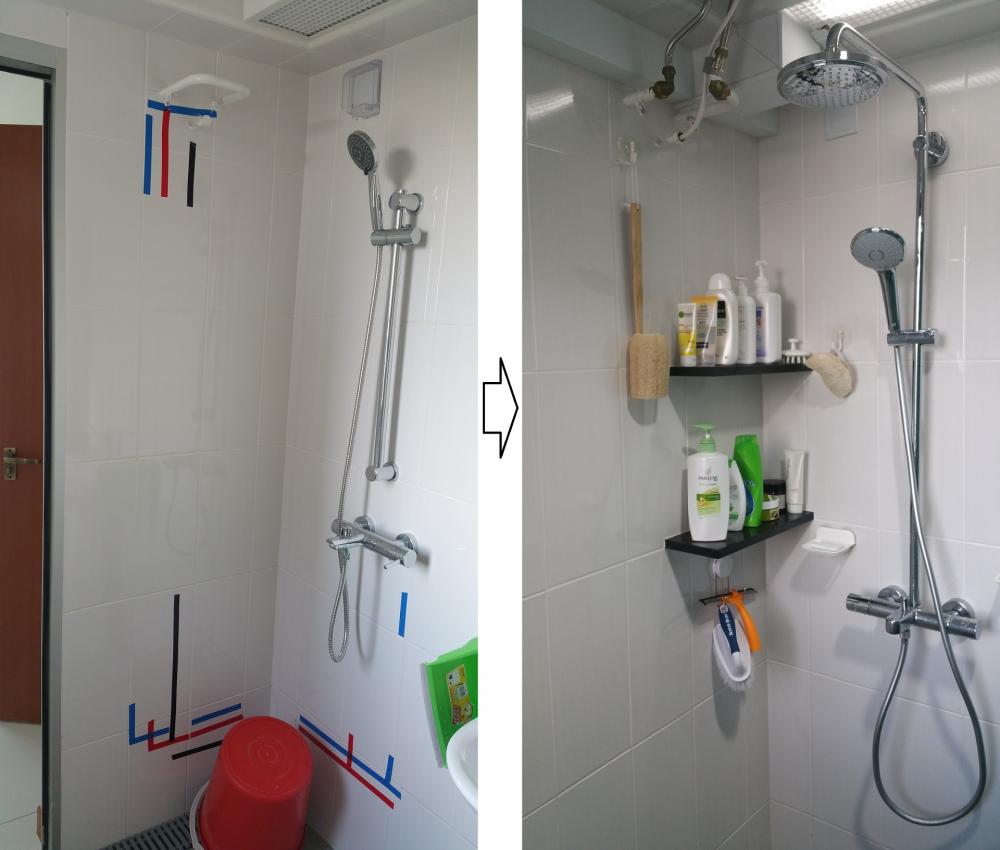

Can i know for the toilet position of the shower piping, from the hdb showroom visited, i always thought it was positioned at the middle. Do you know if all the water piping is original like your bto for all the 45sqm 2room?
11 hours ago, rainbow1979 said:
Hi!
From what I observed if you have your wash basin and WC on the same wall, you will end up having the shower head in the middle of the opposite wall. However if I end up with a middle wall shower pipe, I will just do a wall ledge for shampoo and reposition the shower head pipe by hiding the pipe in the wall ledge to achieve a wet and dry toilet. I was lucky to get this layout but I got the layout with the plastic drain cover instead of step down slope at toilet entrance. My neighbours told me so many hair stuck on the plastic cover they eventually removed all cover and left with a exposed drainage.
15 hours ago, rainbow1979 said:
Hi!
Mine is not at the middle.
My basin and WC on the same wall, shower and window on the same side.  basin facing shower and WC facing window... -_-
