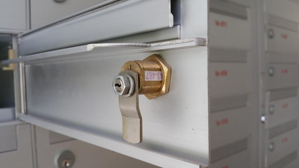

Changing Letter Box Lock
I have no experience and have no idea how the letter box lock works. So I opened it and study the mechanism.
This is the original letter box lock from HDB.
The important thing here is the metal latch which is bended in the middle.
Another view of the metal latch, you have to retain this latch instead of using the new one that comes with the new lock. You will need a adjustable spanner to unscrew the big gold nut in the picture.

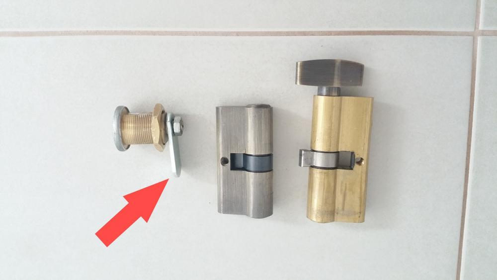

After you removed the old lock, you swap the metal latch to the new lock, the picture here show the latch that comes with my new lock which is not bended.

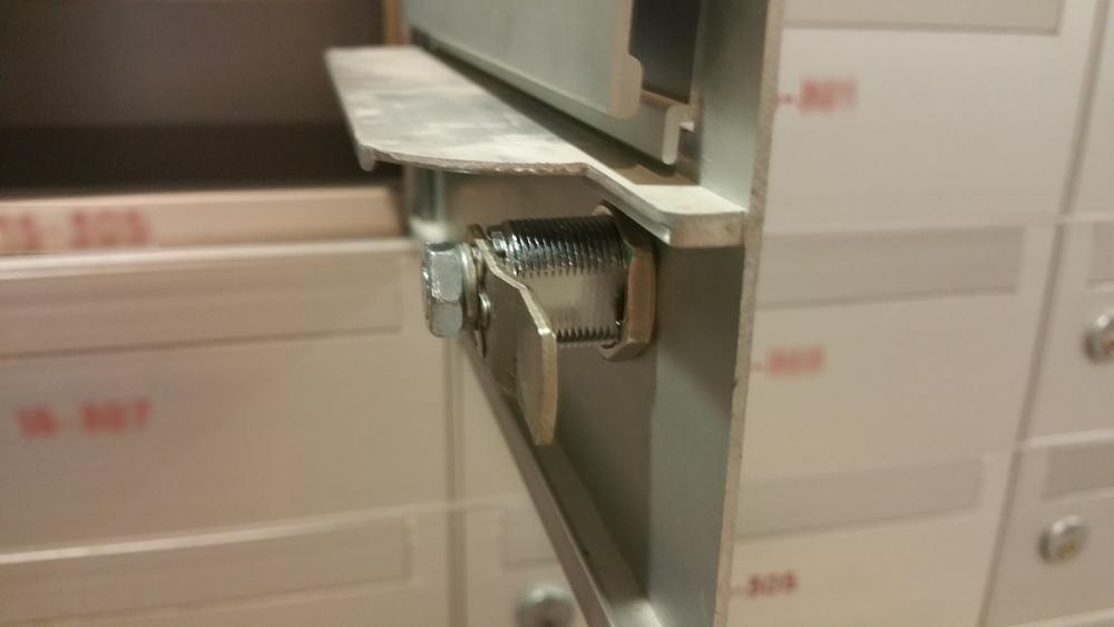

Then just install the new lock using a adjustable spanner. Here you see is my completed installation using the old latch.

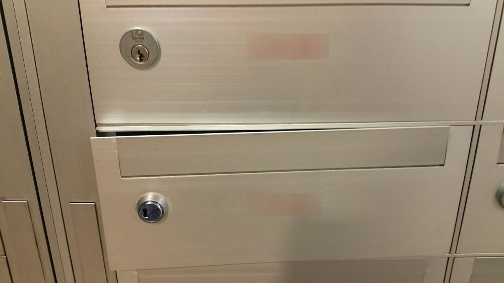

Completed pic. You see the gap is because I used the new latch which is not bended, so will have a gap. By using back your old latch, it will be a perfect fit, or at most some slight adjustment using washer and plier you will make it seamless. I completed everything in 10 minutes being a first timer.

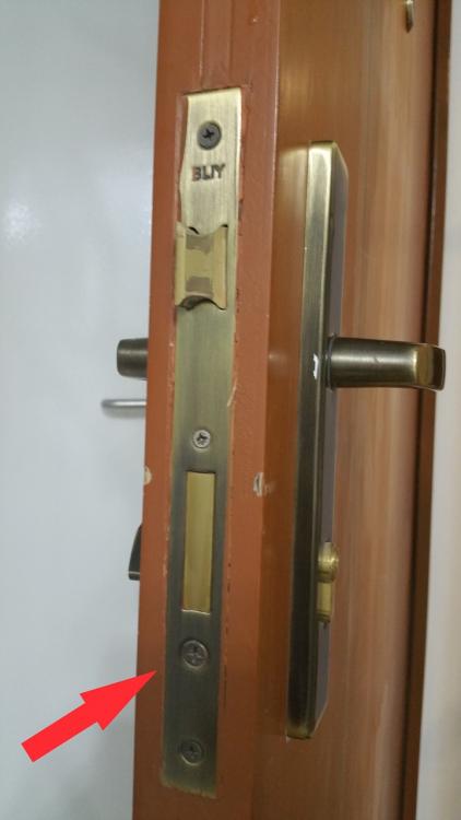

I might as well mention how to change the main door cylinder too, all you need is to unscrew the screw as pointed by the red arrow.

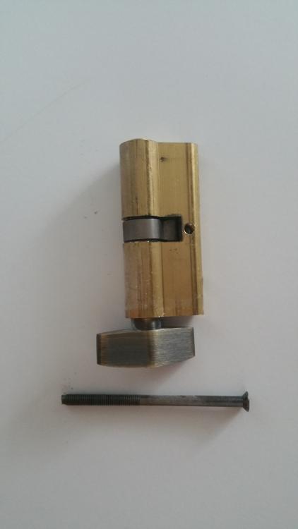

The screw is very long, you can see the hole on the cylinder that it locked into. After that you can install the new Duro lock which can easily buy from Homefix.
