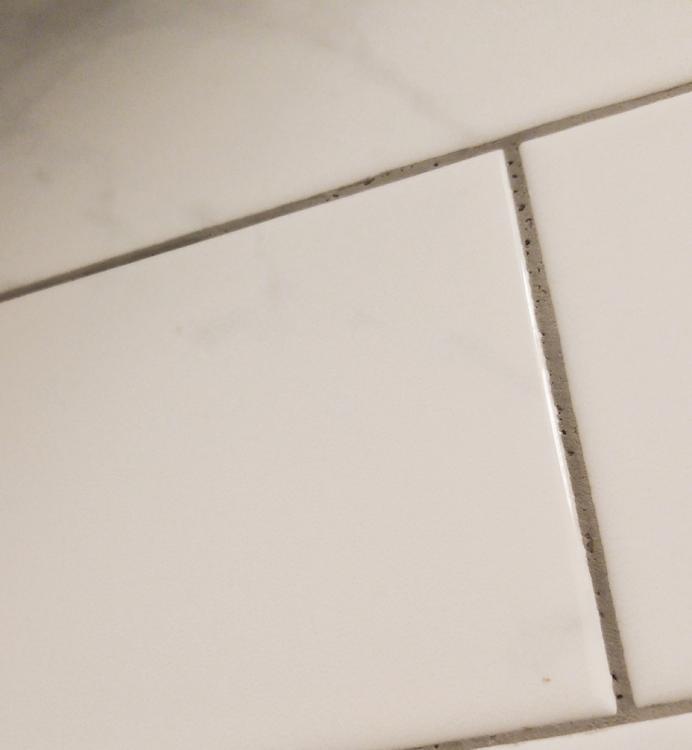

Some subway tiles in the bathroom was replaced because of chipping at the corner, after they replaced it, the grout as you can see from the picture, there are tiny holes and the grey tone is much darker than the rest. (I noticed this before the acid wash)

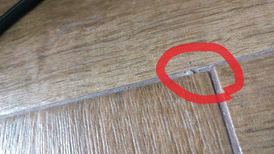

The brown tiles in the picture are my floor tile for living and bedroom, after cleaning, there are so many, so many, so many holes and even some cement still stuck on the grout! I thought acid wash should had it clear up?

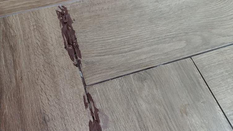

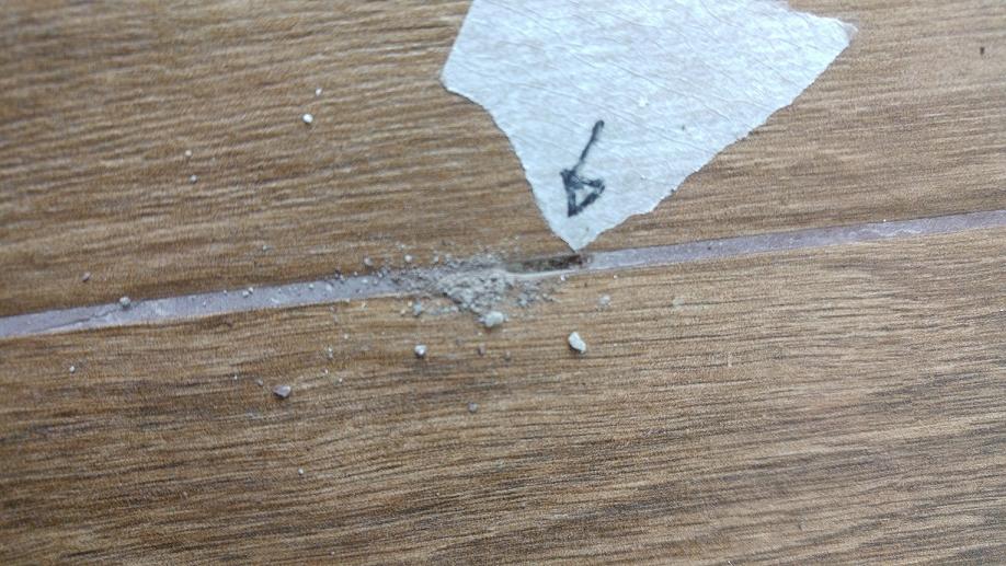

Digging the whole grout and filling in. You can't just dig a small part of the grout out where the tiny debris is because the new grout will  not 'eat' in and will come off easily. I had a heart to heart talk with my grout and he told me "it's all or nothing".
