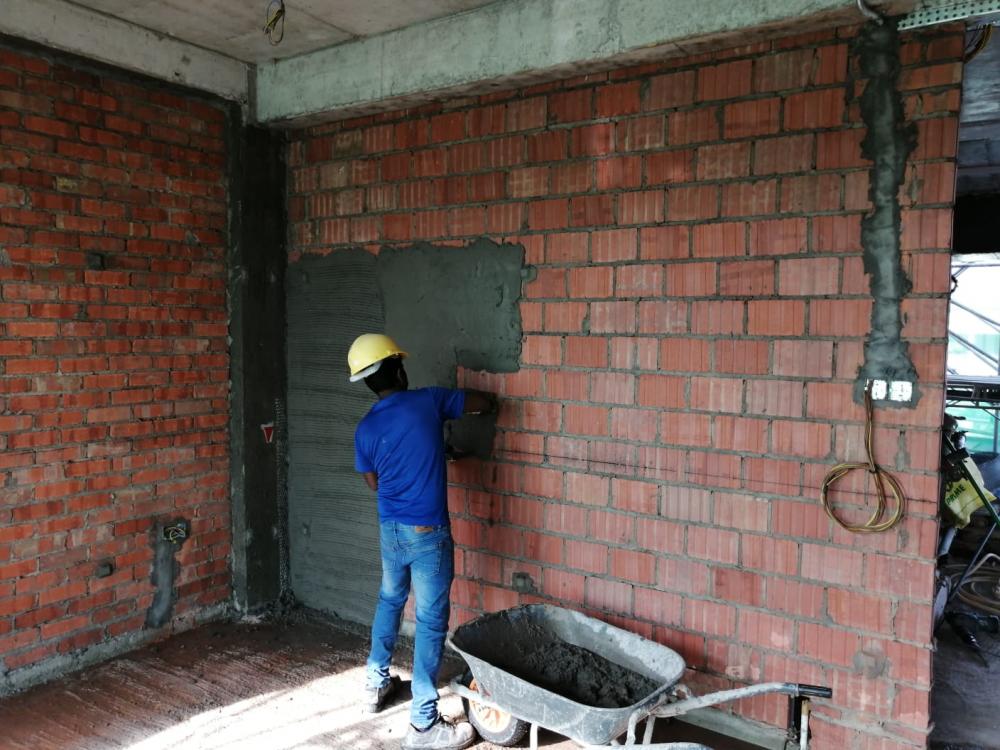

2 hours ago, George Yeo said:
Internal walls plastering begins..
Is this your kitchen? Cos the light switch seems to be much higher than the 1.2m requirement
20 minutes ago, George Yeo said:
it is 1 of the 2 common rooms @1.3m
I may be wrong but my understanding is that BCA mandates that all light switches and sockets must be between 450mm and 1200mm from the finished floor level with the exception for kitchens. you may want to confirm with your QP on this requirement.
Initially the height was 1m but I don't like too low and asked for 1.3m, and they mentioned no problem after checking.
Thanks for highlighting it to me.
