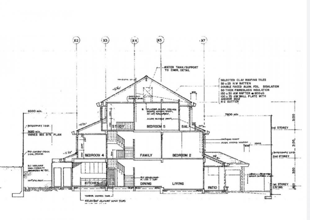

Attached side elevation plan - essentially want to create 2 more common bedroom and toilet. Is it possible to extend 2nd and third floor as an A&A ? Plus full interior renovation. Does it still look like a 800-900k estimate? Was hoping 500-600k
Also current roof tiles as per the plan states is clay tiles. If not leaking, can keep as much of original or advisable to change to different type? A contractor came to see and mentioned something about the existing roof should change so that water doesn't retain in gutters
And if change to new roofing what type is better ?
how much you want to extend? the backyard storage room at the rear does not look to have foundations done up (or the foundations are able to support upper storeys) so if you want to extend all the way to 2m or 3m from rear boundary, you most likely need to do proper foundations. since the house is on high ground (based on needing a water tank), you might be able to get away with raft foundation or some footings and need not do piling.
since you need to tear down almost the whole rear sections in order to do the extension, you might not be able to qualify as an A&A anymore if based on 50% facade rule
if you don't want to touch the main roof, then your 3rd storey extension may have to be lower such that a sloping roof can be built and joined below the existing main roof.
roofing options are either RC roof, clay tiles, sheet metal roof, clay tile looking metal roof, and maybe a few more options. RC roof would be most expensive (if i'm not wrong). sheet metal roof may require slightly less slope than clay tile roof so your 3rd storey extension may be able to get some good internal height even if it's slightly lower.
gutters are no longer allowed to be built so if your existing gutters are removed, you need to plan for how the rain water flows down from the roof. I can tell you that the amount of water that can flow down from the roof during a heavy downpour is no joke so proper planning is important in this aspect.
