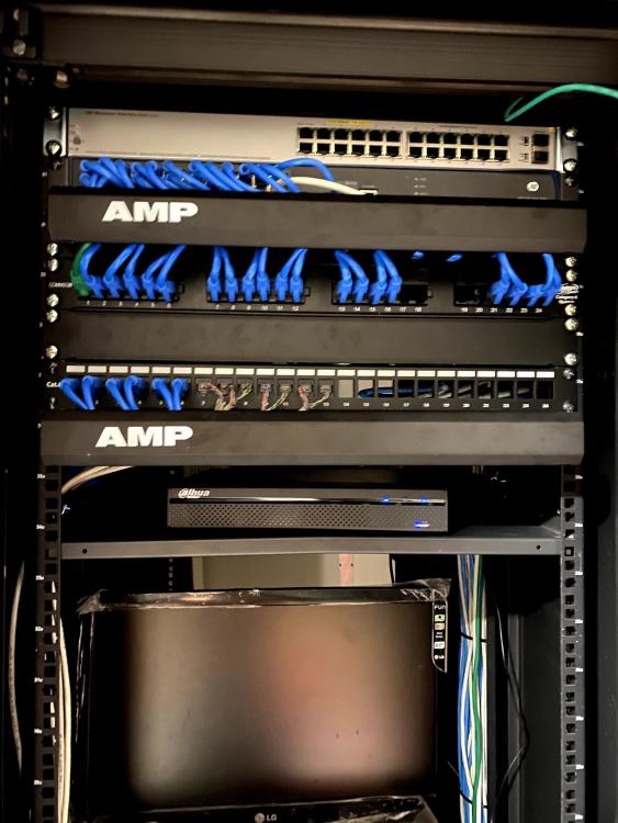

Just to share my home network set up with PBX, CCTV recorder, WIFI controller/POE switch all housed nicely inside a server rack. might be overkill but I prefer to have all the things housed nicely for easier maintenance.

Sorry, I'm not good at this. Do you mean you have a modem in one spot but you use a mesh system that has one unit in every storey? Or do you mean you connect Cat 6/7 cables from one router through the walls into your rooms, with a wired connection point in each room?
not mesh system. mesh will still have problem penetrating RC walls and floors and performance will be degraded.
yes. one modem/router which is connected to the NLT fiber point. the router is then connected to a data switch. all network cables are connected to this data switch. for each storey. there is a network point in the ceiling for connecting a wireless access point.
basically the wireless access point casts the wifi signal for my devices to connect and data is transmitted via cat6 wire back to the switch and router and to the internet.
this type of network is commonly found in big offices or buildings and is called enterprise wifi nework. it gives much better performance compared to mesh networks or just one wifi router within the house.
