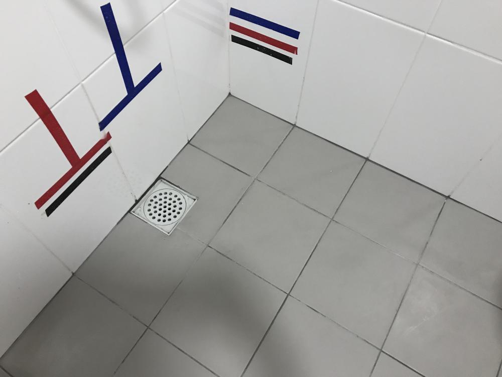

What's outstanding is the common toilet, which we are still waiting for HDB to get back to us because we want to re-grout the entire toilet ourselves. Initially told E there are gaps in the grout, tiler patched up some gaps with cement. When we said we want the effect as in the kitchen (it was nicely done), tiler's next move is ... as what the pictures below show.
IMG_9086.JPG.33c7f8ca3d0155e3dd390be8bd9e3b71.JPGIMG_9085.JPG.34785372f95b930cb8e6e7778bcfccf8.JPG
The toilet floor is completely dry at the time of taking the photos and it's so gross I don't know what to say. This certainly wasn't the state it was in when I handed the flat to my contractor.

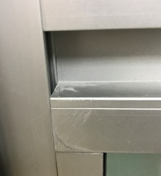

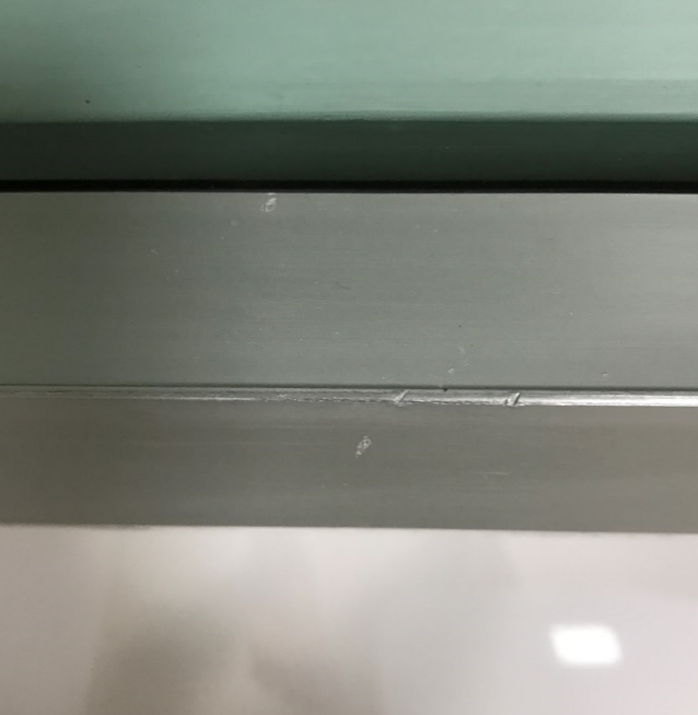

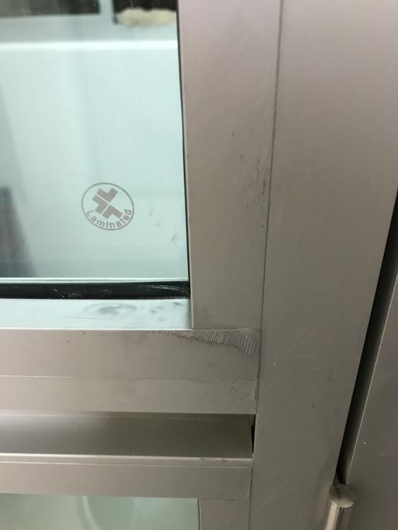

I think I mentioned that I took 5 hours to clean the service yard windows and bi-fold door because of the many paint stains on them. When I was re-cleaning the last weekend (after tiling rectification), I noticed that... the door was 'disfigured'.
We didn't even highlight any defects on this door, but it somehow this happened. The marks in the second picture gives me goosebumps everytime I look at it. :~ This was the last straw. I was angry that this happened, but even more angry that the workers did this but no one surfaced to us. I do not condone dishonesty. I don't believe it is not obvious that these are defects, please.
New scratches and dent too, but at least it doesn't give me goosebumps.
I'm sure someone, somehow, somewhere, something was done because this patch of grey was not there when I cleaned the area previously.
These were the scratches I found prior to the tiling rectification (in this pic they have sanded the sharp edges) and together with other scratches, I agreed to live with because J said it is BSC's windows and he can't do anything about it. Buy hey, doesn't mean you need to give me more scratches lei! :angry:
We decided to take down J&E's padlock - at that point, we only knew that we cannot afford to let their guys into our home anymore because there's more destruction every single time. I have emailed HDB to see if these can be salvaged, though I highly doubt.
By the way, E has responded that they will compensate for the glass top, I will let him know that I want the full sum to be compensated. And also after discussion with my mum, I decided to surface a few other issues. I haven't had the time to talk to my mum (no thanks to OTs) so I haven't replied E for 2 days. In case E thinks that we want to run away from the last payment, I better text him right after this.

Your toilet tiles look terrible. Hope you will reconsider about regrouting yourself. My advise is to get your contractor to regrout the tiles. The funny thing with tile grouting is the more you want it to stay, the more it comes off on its own. Those you wanna remove, just holds on for dear life. Especially grey coloured grout, it seems tougher and stick better compared to the white
My prev reno, the living room tile near the entrance had cardboard stain. Area was 1/4 of your toilet. Tiler took abt 1.5 hrs to scrape away and regrout. He was v careful, and still a tile chipped in the process. It wasnt obvious so i just let it pass.
However if u think u are up for it, do get a pair of gd knee guard. You'll most likely be on all four for hours.

@fingerscross I know right, but what can we do when this is the kind of work we are given? My contractor is rather popular so I'm truly stunned by the quality of work!

I am also having headaches about my toilet's grouting. I had some gaps, and my ID came by to patch it up with cement powder (mixed with water). But the cement powder is white, while the rest of my grout was beige. So yeah... different grout colour now. You mentioned the living room tile had cardboard stain. Was it on the grout or the tile itself?
Hi spooky, the stain was in the grouting. The cardboard was soaked and the colour kind of seeped into the grouting and chemical washing did not lighten it one bit. So ID had to get tiler to scrape it off n re-grout.
White and beige might not be as bad as white and grey. Does it look really weird? Care to share some photos on your tiles?
If you gals know of anyone with one of those high powered water sprays, u can try it out in the toilet and see if the different coloured grouting comes off. Scraping it off yourselves and re-grouting is really not advisable. Very very hard work.
Upon completion of my pass projects, i've made it a practice to ask tiler for some grouting powder to keep in an air tight container. As and when required i just fill the gaps myself.
