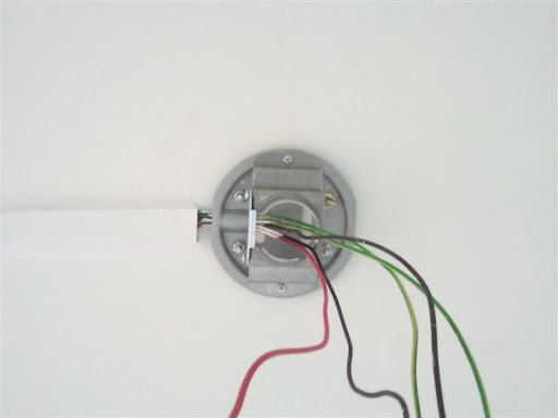

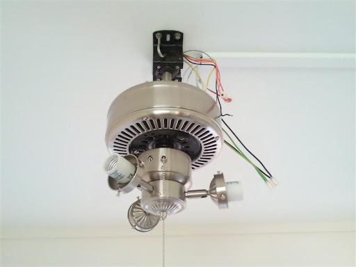

Today, I completed mounting 6 ceiling fans bracket, 5 KDK and 1 Elmark.
KDK Baby Fan bracket...
Closer look, I changed one for the wall plug to those hook type, for the safety wire.

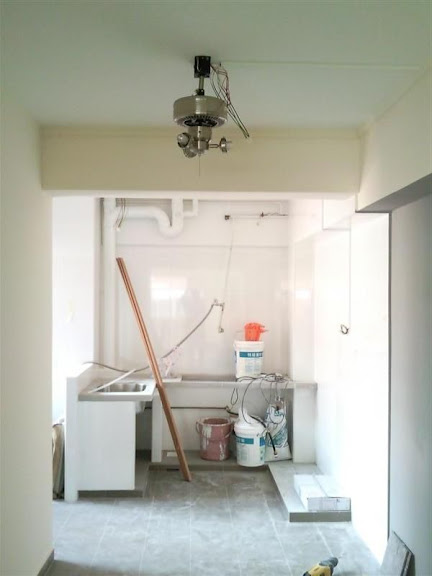

Elmark 30" Fan & bracket...
Zoom-ed in.. Elmark by default comes with 3 plugs and 1 hook plug.

My KDK BB fan wobbles when use at speed 3. Can let me know how is urs when u try? thanks!
Wah u very steady, are u an electrician? Can save a lot of $.
Ya man. Sianz... Out of 5 KDK baby fan, 1 wobble. Try to adjust, shake shake here shake shake there, still the same... But CFM it wouldn't drop bcos I tested the bracket by using it to do pull-up. =D

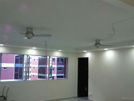

Updates... Today, the downlight installer came and finish mounting 21 downlights. Myself, I completed installing 6 ceiling fan and 1 main entrance light.
Finally I can cover my DB Box and it looks BIG!
My lovely circular lamp at my main entrance and the Elmark 30" cutie in my dinning..
My 2 x KDK BB fan + 14 downlight in my LR
In fact, 14 downlights for my LR seems just nice, each downlight is abt 52 inches apart. Center is quite dim, well 2 more ceiling lights will compensate the dim-ness.
