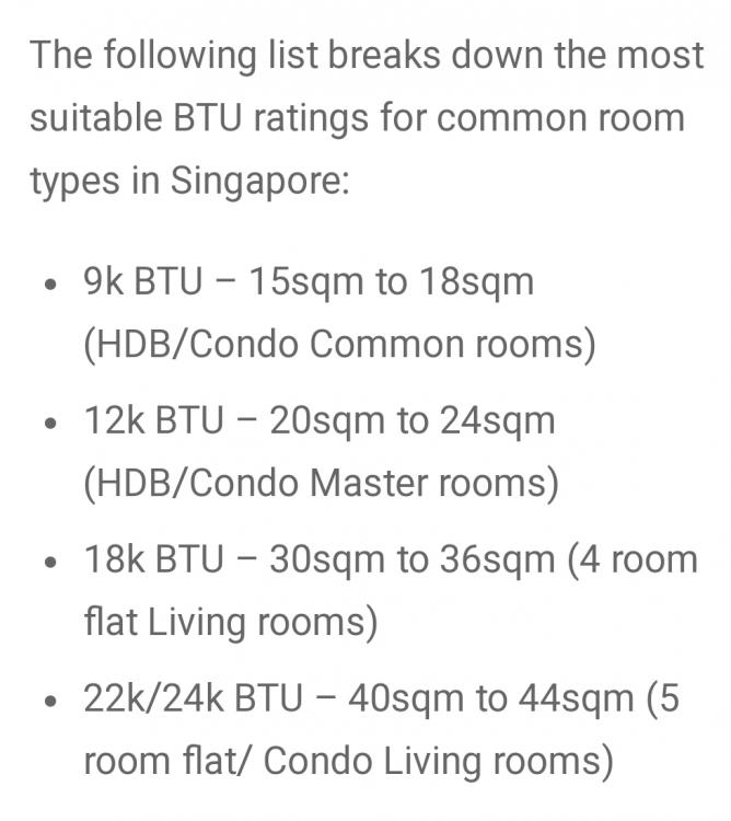

19 hours ago, Kelvin Cheng said:
Hi,
for those who has hacked away the wall between bedroom and living room, how does this impact the aircon?
Do u need to turn on both aircon(suppose system 2 with 9000BUT) just to cool down 1 room?
BTU is relative to room size.
Nice guide. Would be a great reference when I went to select my Air-Con.
Love my 18k BTU aircon at the living room can cool down my whole house lol.
House may be smaller, but it means easier to cool :D

5 hours ago, SuperZ said:
@ryanyth, wow 18k BTU for 2 room unit? That's very powerful!
Only one word to describe: Shiok! :D
Dun think it's economical to get 18k in terms of electrical bills. But it's up to your preference....
