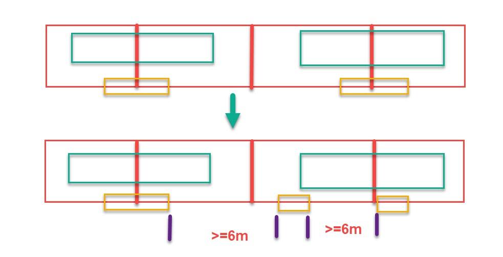

usually gates have to be paired. for semi-d, this would mean the gates for both houses would be next to each other where the party wall is. of cos the exception is that you have a very side frontage of more than 10m which would allow for a minimum of 6m of planting verge within the plot width of your house. eg: if your plot width is 12m, you can have 6m planting verge on the side of a 3m wide gate. the other 3m can be added with the neighbour's planting verge to make up the 6m provided that your neighbour side already has an existing planting verge of at least 3m wide. see picture below.

1) Typically, it is unlikely that you can "unpair" the car access gate for a typical semi-detached of width 8-12m. Like what snoozee has illustrated above, the only case you can unpair the vehicular access is if that particular semi-detached has a large frontage of more than 12m. Aside from this, other considerations would be: Are there any OG (Overground) boxes, lamp posts etc at where you intend to relocate the vehicular access to? LTA/Powder Grid might have restrictions in that case --> distance between lamp posts and maximum distances of the OG boxes from the houses it is serving electricity to. The only way to have a clearer assessment of whether it is feasible would be view the actual site (just through google earth is sufficient usually). If you wish, you can PM me and i can advise further.

1) In this scenario regarding the shifting of the gate, if the width of the land is 11.4m long, and I have to set 6m away from my neighbour’s gate on my right and also 2m from the boundary line on my left , does this mean I can essentially shift my gate and do up a gate that’s max 3.4m in width?

You need to see if your other neighbour’s gate on the left is more than 4m away from your boundary or not. If less than that, then can’t shift. Not sure how you managed to buy the BCA plans as usually owner is allowed to buy or someone authorised by the owner. Like I said, if you really want to confirm, use good old school measuring tape on site to measure. If your family has just one car, 3.4m wide access would be good enough. But if you have 2 cars and want to park both cars inside, you may want to have a bigger gate as 3.4m could be challenging to have free access for both cars. Meaning there would be shifting of cars needed if the car which arrived home first wants to go out. Hope you get what I mean about the shifting of cars.
