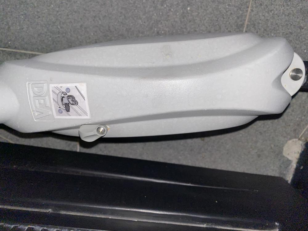

The manual bypass key is activated from inside or outside or both?
Depends on where your door arms are installed. The key is plugged into the arm to bypass. See the photo of my bifold door arm
