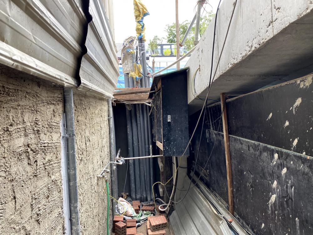

my advise is for you to work out the minor details like auto-gate and video doorbell especially on their wiring requirements first. cos if you don't nail down the wiring requirements at the start, you can't determine how many underground pipes you need to run and how many pipe conduits you need to place inside the meterbox and you will have problems retrofitting these in future without the conduits in place.
Just to share, see how many pipe conduits I have from the house going into the meter box.

Thanks Snoozee. Do i need a PE to be involved in this?
Also, if i move the meter box out, facing out, the sliding gate will open across the face of the meter box. Would this be problematic? Just concerned that if for any reason the meter box door is not closed properly, the sliding door gate will knock it....
PE definitely. your box culvert needs to be designed by a PE and submitted to the various authorities. later on a post-con survey also needs to be done as well to submit to authorities.
if your meter box is setback enough for the gate to clear, then shouldn't be an issue. normally the meter box is built right up to the boundary. but if your gate is going to be at the boundary, then your meter box and boundary wall needs to be set back instead so that your gate track can be installed. also the meter box electrical compartment is locked and water compartment is latched. not sure if there's any regulations on locking of water compartment but if you are concerned about this, maybe install a lock on the water compartment door as well.
