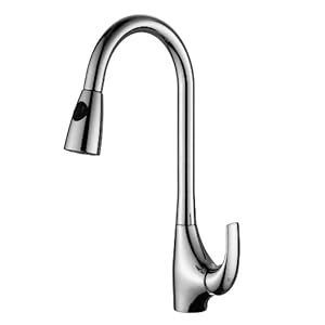

Kraus KPF-1621 Single Lever Pull Out Kitchen Faucet, Chrome
Hi guys, saw this at Amazon. Like to hear some opinions from you all. I think it's quite cheap but I am worried whether it can be used in Singapore. I know nuts about pumping etc.. Any experts here can advise? Thanks!
thks for dropping me a msg at my t-blog. thks kim76 too. I got this faucet but yet to install by plumber. so far haven't heard from the plumber of any issues. fingers crossed. He will be installing it within these few days.only worry is the water tube size :unsure:
oh forgot to also mention that this faucet is tall. good to be combined with a 30-32 inch sink. Now i really regret not getting a bigger sink!!!! :P
Hi,
Have not tried buying mixers from amazon us before. Did check out the hansgrohe mixers on amazon previously but noticed that the last 3digits always differed from the part no. used in Singapore....plus know about kim76's difficulty in connecting his filter/faucet, so in the end dared not buy from amazon and bought from insani24.de instead ( germany online reseller).
Let us know if it can fit without use of additional adaptor. Fingers crossed....

The plumber came to fix up the kitchen sink faucet and connect the sink trap. :sport-smiley-004:
Glad that the faucet is able to be connected and realised that it is actually a common thing for mixer faucet. My current house also uses the same adapter. :sport-smiley-018:

Could the difficulty comes about due to the tap threading of American National Standard vs our local Unified Inch Standard? :dunno:
Please read this : http://www.ring-plug-thread-gages.com/ti-N-vs-UN.htm
I not sure if anyone interested. But I will post here since we are talking about sink. I did post this in my T-blog though.
Hi all,
After 2 days of running to different hose companies & hardware shops, I think I may be able to solve this issue after all.
A bit of background, the 3M filter comes with 3/8 tube. The facet need 1/4 tube. Our HDB water pipe is 1/2". So we have 3 different size to play here.
First, we need a connector from HDB 1/2" to 3/8" hose.
SMC KQ2H11-37S PBT Push-To-Connect Tube Fitting with Sealant, Adapter, 3/8" Tube OD x 1/2" NPT Male with Brass Threads
Then a connector to convert 3/8" to 1/4" tube.
SMC KQ2H07-11 PBT Push-To-Connect Tube Fitting, Adapter, 1/4" Tube OD x 3/8" NPT Male
I did not buy from Amazon. Just provide a link for u to reference. I bought locally at SMC main branch walk in sales counter.
SMC Pneumatics (SEA) Pte Ltd
33 Tuas Avenue 8
Singapore 639251
Tel : 65-68610888
Fax : 65-68611889
URL: http://www.smcsing.com.sg
And lastly U buy a 1/4" tube. :good:
