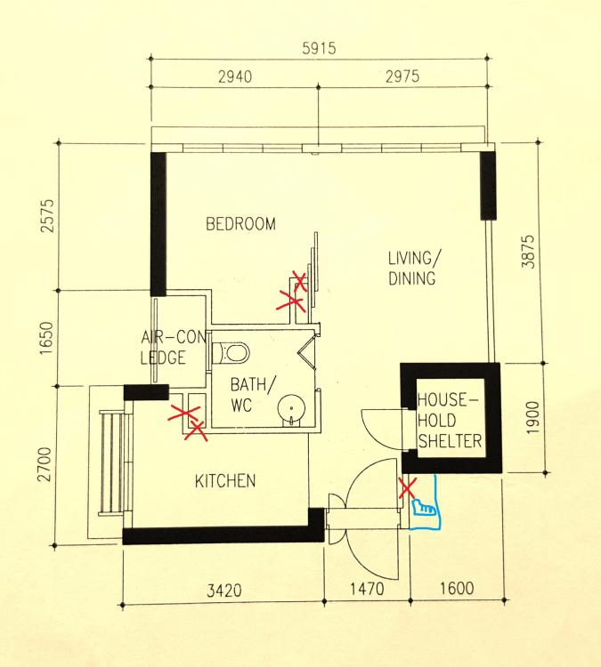

Does anyone know if my plan to knock down the walls marked with a red X would work? I live on the top floor, so I don't understand why there are walls (not in black) that enclose space in the blueprint. I think they are walls for piping?
I would also like to build a shoe cabinet next to the front door, indicated in blue, because there is no space inside the flat near the front door to build any shoe cabinet.

Answer to all your 3 red X is NO. The front door part is obvious, that is the boundary of your unit. You also cannot build a cabinet at the blue area but you can but a shoe cabinet and place it there if it does not block the passage way. BUT, beware of thieves. The one in the kitchen is where the washing machine drainage piping goes. The one in between the living room and bedroom is actually the DB box, where it house your unit's main switch and ONT. It is in a form of cabinet properly done up by HDB. You can put planks so that you can used it as a small storage cabinet.

@Kitchen those walls conceal the duct pipes, eg. Gas, Sewage, Drain and PUB pipes. Checked with various IDs I sourced could not hack those as it is against HDB rulings.
@Living/Bedroom those walls housed DB Points, eg. Electricity Circuit Breaker, Telephone Line, Fiber/Ethernet Point, SCV Point. You may choose to hack those provided the costs of re-wiring would eat up your overall reno budget; as I found out it may be feasible to do so but could not guarantee its lifetime warranty.
