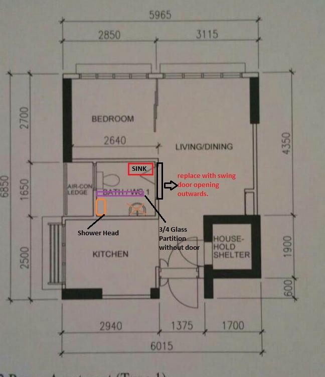

Rufus, I think the best design is to put a L-shaped shower screen. But u need to measure the actual area to get the measurement. Standard I think 90 x 90 but can be done 80 x 90. Try to extend the max til the window area. As long as there is wall will do. The basin can be reposition towards the wall to give more space for the shower screen. But then I think your concern is towards the WC side... You can ask ur ID if there is any sample of 80cm width shower screen for you to have a feel of the width.
If you insist on the blue line, what you need to do is 1) reposition the basin to perpendicular wall 2) remove the bi-fold door 3) reduce the width of the bathroom door by extending the wall 4) buy a new bathroom door.
This will make your wet area similar with mine, ie. having the basin inside the wet area.
Hi mmoh, i recently go check out my frend Lake Life EC just to get a feel as hers was also 75cm facing the shower, but the length was not 90cm. it was like my vision (the blue line) i used a measuring tape to feel how 90cm would be like.. it was very confining.. feeling like a goldfish in tiny glass cup.. lol...
yes.. like you suggested, i want my blue line.. and plan to remove my sink and position it at the shower head area and have to remove folding door and put a opening outward frosted glass door. Have attached my revised vision.. Pls let me what you guys think? pros and cons (area of improvement).
My main requirement, Dry Area must have toilet bowl and sink (dont want these 2 get in contact with water during shower)
My wet area is only shower area.
On 5/24/2017 at 3:09 PM, Joterloh said:
Hi Rufus,
For your L shaped shower screen, I assume it will be resting on a L shaped curb.
Please do also take into consideration of the location of the floor trap in your toilet and how the water is flowed towards the floor trap.
You don really want the water to be trapped at the corner of the L shaped which you need to "physically" clear/sweep the water to the floor trap, which happens to me. :wacko:
Hi Joterloh, i am not sure where the 'L shape curb' u are referring..
lol, have to  be patient with me.. i'm a dummy when it comes to flr plan.. i am still getting the hang of it.
Thank you for bringing up abt the the floor trap.. i dint' factor it in... :0
is your flr plan similar to my toilet, any idea where my floor trap will be?

On 5/25/2017 at 1:44 PM, ryanyth said:
I dun see why there is a need to block water to WC area? In fact the position of my current WC is same as my future apartment right next to the shower area and i find it even more convenient cause i can just aim showerhead at the WC to clean and wash it if i want.
Are u worried that the water will make the seating area wet when want to do business? A simple wipe down with tissue paper will do. And anyway where my shower is positioned, I won't get the WC wet unless I purposely spray it directly.
Hi ryanyth, hahaha.. i got abit of OCD.. i don't want to step into wet area where toilet bowl and sink is concern.
i want them dry.  imagine after bathing, smell nice and fresh, see the toilet bowl / sink dripping water and tiles wet... the toilet will be very humid (due to hot shower)
in tat state, if i have to do drying, wiping and moping, end up perspiring... lol..  plus morning is always a rush, bath, get ready leave hse for work... i cannot do a proper clean up and go work leaving being a wet toilet (my OCD will go into overdrive), thinking abt water stains etc.
i really want them in dry area..
On 5/25/2017 at 5:41 PM, mmoh said:
ok, what I mentioned was with the presumption that you want to split the wet and dry area, which Rufus required.
Rufus, another alternative is to have shower curtain instead.
Yes,, u are most certainly correct.. lol.... i really want a clean split with wet and dry area!
i dono mmoh, somehow i feel shower curtain very flimsy.. in hotel stays, showering in bathtub with curtains drawn,, still the floor gets wet..
let alone a small kerb??
In order to construct a glass shower screen, you need to install a kerb at the base for the shower screen to stand on it. This is done by the tiler.
The floor trap should be right in front of the shower area. But there are some bathroom got 2 floor traps but mine got only 1.
If you want to consider shower curtain, you will still need to install the shower kerb and the shower curtain have to be long enough to be able to overlap with the shower kerb so that when water splash onto the shower curtain, the water will still flow within the shower kerb area. But of cos it is flimsy and may not be able to prevent water from splashing out as good as glass screen. but the good thing is it can be kept to the side and it does not look so crowded within the bathroom.
Actually, even with the glass screen, the wet area is still wet after shower (of course) and I recommend to clean the glass screen, wall and floor tiles dry so that there will be no water stain on the glass and tiles. I do that every time currently and end up perspiring again after shower -_-".
The position of your WC does not impact on the width of your shower screen, but rather the big window that is behind the WC is the deciding factor.
Your re-positioning of the sink is a big task cos the re-routing of the water inlet piping and water draining piping is too far and it cross over to the other side of the door.
Hi Rufus58,
mmoh is right about the installation of the kerb at the base for the shower screen.
As for the re-position of the sink, it involves modifying the toilet's tiles.
you might not be able to do it if yours is a new BTO flat, under question 11 of the FAQ in HDB website. see link.
http://www.hdb.gov.sg/cs/Satellite?c=HDBeService&cid=1383797726214&d=Touch&pagename=InfoWEB%2FHDBeService%2FeServiceArticle#Q6:

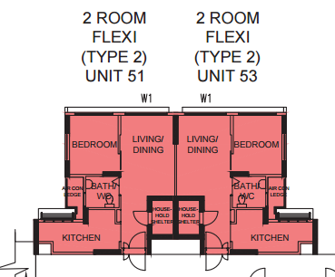

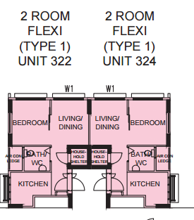

Hi all,
I'm patiently waiting for my 2room at Fernvale woods.TOP 3Qtr 2019.
I have a question if any of you could advise that is it possible to hack the wall to make a toilet door for bedroom? and Do we need HDB approval?
Thanks!
Hello diraf,
It seems there are 2 floor plans for 2room houses.
Photo 1 - only wall. In this case, might be able to create/relocate the door to between toilet and bedroom. Your future contractor will submit to HDB and seek approval for it.
Photo 2 - a column between toilet and bedroom, the thick black rectangle is a column. In this case, most likely cannot be hack because it is a column. Furthermore, the wall location is at the sink area which there is not enough space to install a door there.

1 hour ago, Joterloh said:
Hello diraf,
looking at both picture, diraf's should be the type 1. Even if type 1, are we allowed to change the door location for bto?
Hi mmoh,
Submission is require for the relocation of door to HDB before the renovation, and the decision will be up to HDB.
BUT I know HDB has this rule under their HDB FAQ -
"New flats owners are not allowed to remove their bathroom/toilets' floor and wall tiles provided by HDB to their new flat within three years because of water-proofing of the toilet."
Which mean if the relocation of the door affects the wall tiles and floor, then most likely cannot re-locate. UNLESS the contractor/PE can suggest/show methods that toilet walls/floors are not affected.
