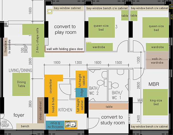

Here's the original floor plan and the design we plan to do :
Things to do :
• Foyer : (1)Full height shoes cabinet (2) bench c/w storage cabinet.
• Living Hall : (1) Homogenous tiles (2) L box (3) TV console
• Balcony : (1) level up and lay homogenous floor tiles (2) install white casement window.
• Kitchen : (1) Counter bar (2) Cabinet with laminate soft closing doors. (3) Floor tiles (4) misc.
• Common and attached bathrooms : Hack existing and re-build all.
• Master Bedroom : (1) Bay window bench c/w storage cabinet. (2) walk-in wardrobe
• Common Bedrooms : (1) Bay window storage cabinet.
• Service Balcony : Transform to study room -- flooring and wall tiles, study table.
• Study Room : Transform to play room -- (1) Fabricate wall with sliding glass doors. (2) Bay window cabinet.
• Plumbing, electrical, cleaning ..

Just a comment, the washing machine and dryer with little gap to kitchen counter? Will you be able to walk in between? Or even open the door of dryer?
Thanks May_dream1, we also have some concerns on the little gap .. guess it was around 0.4m and shall be ok to fit in one person. Our washing machine was top-loaded, so shall be ok .. hehe.
Update of layout to include the wordings:
- convert service balcony to study room ... wonder if anyone do this before?
- current study room will change to play room ...
Thanks Jaskel ~ your girls are cute ... my girl still stay inside my tummy, only 4mths now :P dragon girl. Thanks May_dream1, we also have some concerns on the little gap .. guess it was around 0.4m and shall be ok to fit in one person. Our washing machine was top-loaded, so shall be ok .. hehe. Update of layout to include the wordings: - convert service balcony to study room ... wonder if anyone do this before? - current study room will change to play room ... 1343172577-2053551639_n.jpg
I m impressed with your drawing - so neatly done and precise. I like your flat layout too. Good idea to convert service balcony to study room but the entrance can be from MBR rather than kitchen. What abt your laundry? without a service balcony/yard, how do u intend to hang ur clothes/place your mops/broom?
Edited by potatoes
double congrats! going to have a baby dragon gal..... :dancingqueen:
you put there as washing machine and dryer. For washing machine, you can get top load, but i have not seen a top load dryer. all are front opening so i am not sure whether you can put both dryer and washing machine side by side with only 0.4m space only. And you can't stack your dryer on top of your washer since your washer is top load.
Like what potatoes said, where is your store room? you will need a store room to put all kind of stuff unless your playroom is cum store room as well (which is not advisable since your kids will be inside playing). i see you have 2 sided to full height cabinet..... is one of it so called store area?
Hi potatoes, I draw using photoshop (i.e. can have different layers for different items) .. I guess autocad can give more precise drawing but I long time didn't use autocad :P
There will be 2 entrances to the new study room, one from master bedroom and one from kitchen. Previously I only think to have one door connect to MBR but my husband said he want to have a door connect to kitchen as well .. so at night while using his computer at study room, he can enter to kitchen directly without passing by our MBR.
We not going to hang clothes as we are using dryer .. Right now in our Bedok 3 room hdb, we also didn't hang clothes .. everything go thru dryer .. we are super lazy type :P
Thanks May_dream1 ~ will be a 2013 baby dragon if she not coming out earlier ... hehe. 2012 too many dragons, hope can avoid.
Our dryer is front loaded and it has no problem to access because the washing machine will put near to wall while dryer will put outside. i.e. still can load or unload the clothes from dryer front side ... yeah, we cannot stack our washer and dryer unless we want to buy new front loaded washer ...
You guys are right, there is no storeroom. Some of the design of this floor plan have storeroom between MBR and the common bedroom but ours don't have. We are going to use a lot of spaces from baywindow cabinets, shoeshelf, kitchen full height cabinets, walk-in wardrobe to store our stuffs .. or may be some can put inside the new study room (plan to have some shelfs inside the study room). Definitely not going to use space in play room ..
