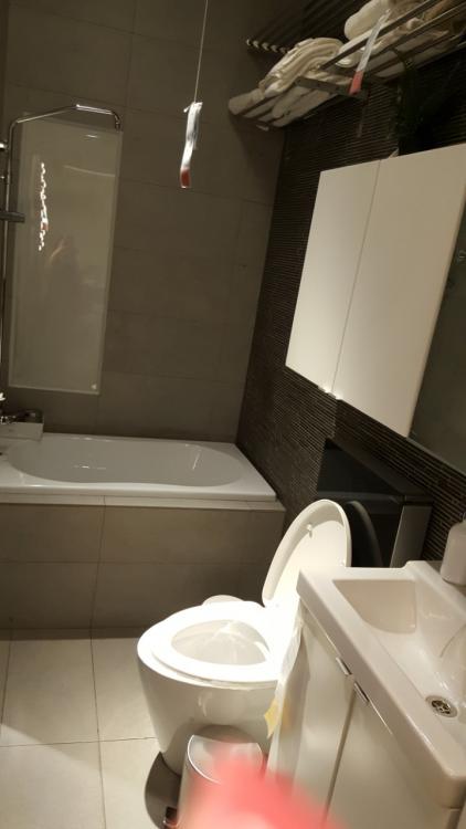

    @CaseBlue Here are the pictures of my completed bathroom. Hope it will help. Note: My bedroom-side toilet door (slide and swing) has customized dual locks. This way, I can lock from bedroom for p

Very nice layout ideas for the new bto design. Many great ideas can be incorporated into this new design. Love the bathroom too. Maybe u can consider install a mini bathtub there.
Went to IKEA at Tampines with my friends today and saw this bathtub.However, my friends say it's not feasible and I will have a hard time cleaning the bathtub and no place to do laundry washing in the bathroom.

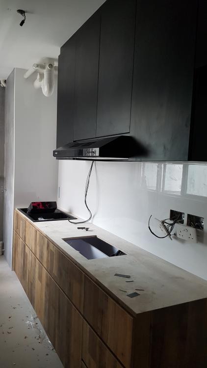

My kitchen cabinets almost done. Think cooker hood abit too low..
I assumed the fridge will be at the right side of this picture? I read that kitchen setup would be good to based on the concept of "work triangle", the setup will follows "Preparation -> Cooking -> Washing". Your setup seems to be a single wall kitchen. Do you think it would be good to have the sink in the middle rather the stove? So that you end up walking less in preparing meals.
The sink being just beside the wall, would that lead to water splash?
Did you take your height into consideration when designing the kitchen, else it might end up you bending over too much or over reaching.

Yes, fridge will be on the right.
I usually take out everything that i need from the fridge when prep for cooking. So having the sink at that corner wouldn't pose any issue for me.
Beside, this configuration is very similar to my current house and am used to it already.
My only complain is kitchen counter and cooker hood abit low. My id didn't even consult me on the measurements despite numerous attempts to press him for the measurements. He kept insisting this is standard height. Since it's not that low to the extend that i have to bend when prep for food, i've decided to let it go. At least i could reach the top cabinets to console myself.

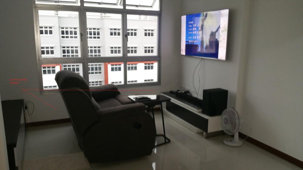

Hi all, I'm new to this forum
A question, can the wall below the windows be hacked lower to extend the window frame?
image credit ryanyth from another thread

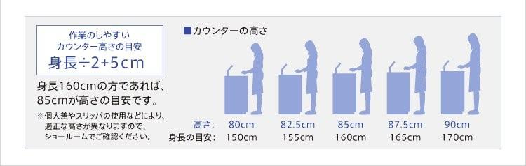

position of sink will depends on the inlet & outlet piping location.
Height of kitchen cabinet:

Oh didn't Knw this kind of measurement even exist.. Thanks @mmoh

sink can still move...i moved my sink to the back of the kitchen because i wanted it to be away from my main countertop.
